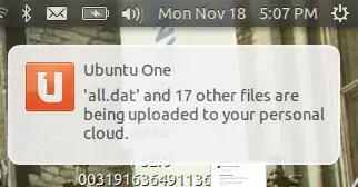

After installing LXDE to my Ubuntu 13.10 system, the notifications tooltip theme changed and it remains after uninstalling LXDE.
Also before that, pressing Fn + Arrow Keys in my laptop I could change the volume and brightness settings and a tooltip would show up indicating the current levels, but now that doesn't show anymore.

Just remove xfce4-notifyd package and reinstall notify-osd if is not installed. Restart your desktop session.
sudo apt-get remove xfce4-notifyd && sudo apt-get install notify-osd
