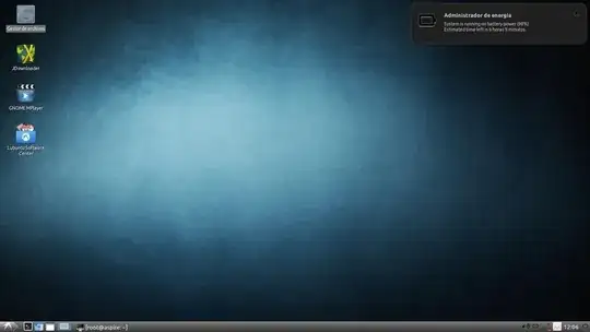

I want to see smaller pop-ups but where have I to go to configure this?
For example, when power manager pops up: I want a smaller notification
maniat1k
  • 8,340
Depending on the OS version, one may have to to replace the existing Lubuntu notify pop-up with the XFCE equivalent:
XFCE Popup enter image description here
Lubuntu Popup enter image description here
It has a simple config GUI (xfce4-notifyd-config) - by default the notification size is smaller - similar to the Unity pop-ups.
Since all the desktop popups work with the same underlying libnotify - using the XFCE variant in Lubuntu is fully compatible.

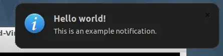

Install notifyosdconfig
sudo add-apt-repository ppa:nilarimogard/webupd8
sudo apt-get update
sudo apt-get install notifyosdconfig
Full Tutorial: http://www.webupd8.org/2011/05/configurable-notifyosd-bubbles-for.html
Screenshot
From tutorial
