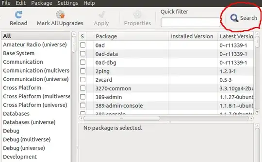

Start synaptic,
sudo synaptic
You get the opening window of synaptic. Select the files you want to install using the Search function.

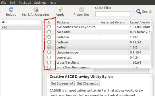

Marks the packages you want to select, either left mouse click or right mouse menu-select. Finish marking all the packages you want.

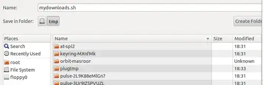

From the File menu generate the download script.
Save the script at some convenient location. Use any file name you like. Let us say your name is mydownloads.sh
If you close synaptic, you can ignore the warning about not installed packages.
The script is a simple shell script, containing a series of wget commands, like the following,

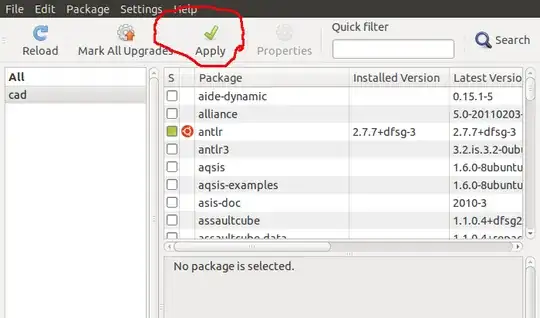

From the file menu, use the Add downloaded package function to select the directory in your computer where you copied the downloaded files.
Click on Apply. Installation of your downloaded packages should go without any problem.

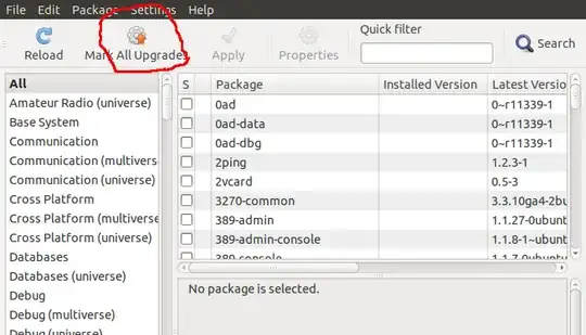

From time to time, you will need to run
sudo apt-get update
at your slow speed machine, select Mark All Upgrades in synaptic and then go through the process of generating the script, download the files at your high speed machine, and then install the downloaded files to keep the slow machine upgraded.
