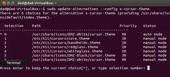

First in a terminal type:
sudo update-alternatives --config x-cursor-theme
Choose the number of the theme you want - e.g. 0 for DMZ-White
Changing the value here requires a reboot - a logout and login will not suffice.

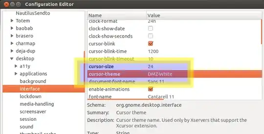

Secondly, using dconf-editor (install using sudo apt-get install dconf-tools)
navigate to org.gnome.desktop.interface
change the cursor size to 24 and cursor theme to DMZ-White

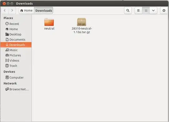

  1. Download your favorite cursor theme from Gnome Look or other sources, and untar it in the folder you downloaded.

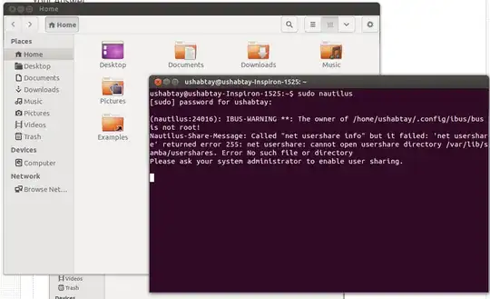

  2. Next, open a terminal and type sudo nautilus and a Root Nautilus will launch. BE VERY CAREFUL DELETING AND MOVING FILES IN IT enter image description here
  3. Now, go to your downloads folder (from the Root Nautilus you just opened) and copy the folder of the downloaded cursor theme (not the .tar archive)

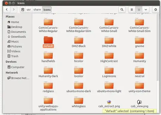

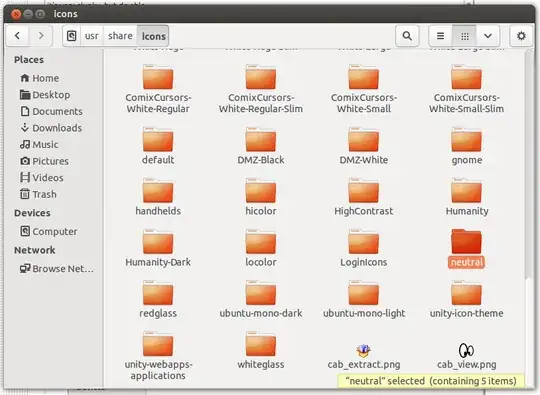

  4. After doing so, go to /usr/share/icons and paste the folder of the cursors. but don't close it just yet. enter image description here

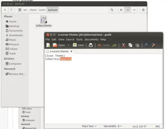

  5. Within the 'icons' folder you'll see a 'default' folder - open it - and open the 'index.theme' file (in gedit, in-case it doesn't open automatically), and change the theme name to the name of the cursor folder you copied (for example: 'neutral'). save and close the file. enter image description here enter image description here

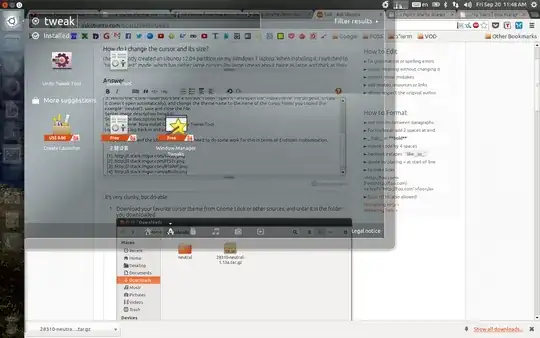

  6. Almost done. Now install Gnome/Unity Tweak Tool and change the cursor theme within them. enter image description here In the Gnome Tweak Tool it look like this: enter image description here
