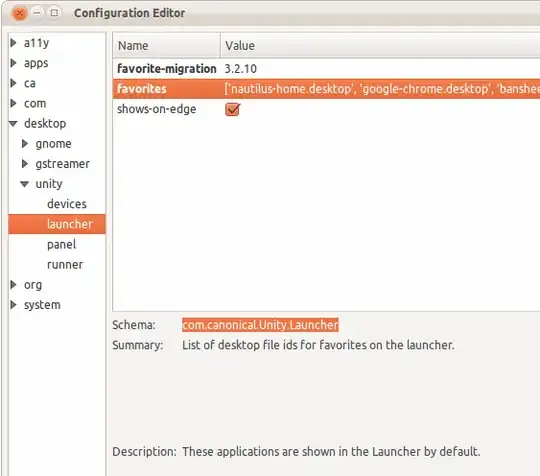

  2. Run dconf-editor and navigate to the key you want to change the default for. Note the Schema name, in this example that is com.canonical.Unity.Launcher:
