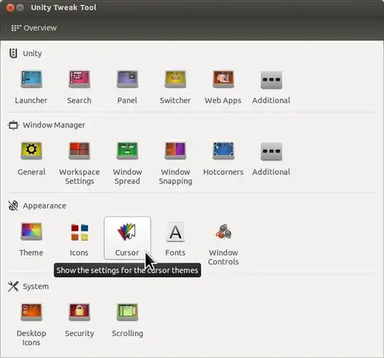

If you prefer GUI you can use unity-tweak-tool.
How to:
Open Ubuntu Software Center, search for unity-tweak-tool and install it.
Open unity-tweak-tool. Under Appearance, click on Cursor:

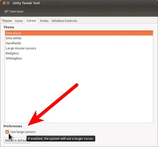

Under Preferences enable ☑ Use large cursors:
Logout and log back in.

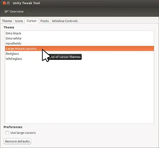

Custom Cursor Themes:
If you don't like the default cursors you can download a nice, large cursor theme from here.
Extract the downloaded archive to .icons directory in your home, create .icons directory if it doesn't already exist.
Open unity-tweak-too and go to cursor settings as described earlier and select Large mouse cursors:
enter image description here Logout and log back in.
