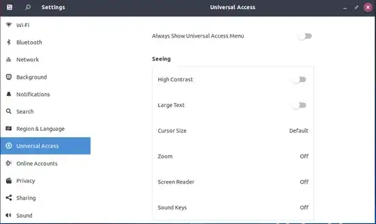

Alternatively, you can also try a GUI method. Open SettingsUniversal AccessCursor Size:
Universall Access window

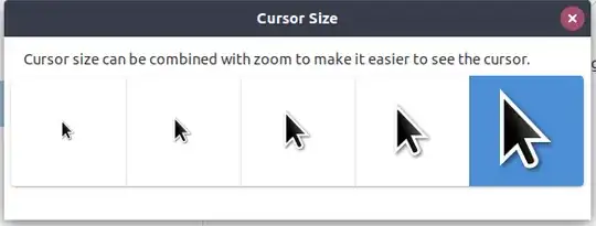

and choose your preferred size.
Cursor size window
