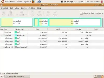

Screenshot of gparted
gparted is a very easy to use tool, and yet very advanced.
