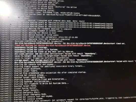

- Windows works fine, but now Ubuntu is broken. After the LUKS password page, it stays for a really long time and then goes into emergency boot.

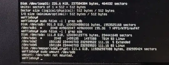

- My suspicions are because the HDD that was mounted at /storage got wiped and assigned a new disk letter or something, so its trying to load a drive that isnt there (got renamed) and crashes?
Attached some relevant screenshots below. Would really really appreciate all help!! Thank you :)
