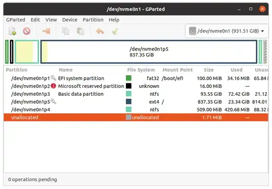

  2. The screenshot of GParted:
For anyone who meets the same problem as us.
There is a temporary solution to this issue.
We think it is a problem with the Linux SATA driver on the motherboard. Our motherboard is ASUS Pro WS WRX80E-SAGE SE WIFI.
Unfortunately, we did not find a permanent solution to this issue. Our temporary solution is to connect the 12T hard drive to the M.2 port through an M.2/SATA converter.
Furthermore, remember to change the corresponding M.2 port from 'PCI-E' to 'SATA' mode in BIOS.
Detailed Step: Enter BIOS setting -> Advanced -> Onboard Devices Configuration -> U.2_* mode -> 'PCI-E' to 'SATA' -> Save and exist.
* represents the id number of the M.2 port used to connect the hard drive.
