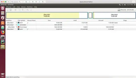

Below is the output from gparted application,

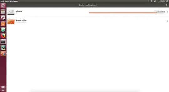

Below is the output from Disk Usage Analyzer application,
I would like to understand why newly added 10 GB is not part of DUA. Is the newly added 10 GB not considered for system usage?

  1. It seems that you have added the added space as a new partition, sda3.
  2. In /etc/fstab you are trying to mount sda3 as /, but you have already mounted sda1 on / earlier in fstab.
From your question it is not clear to me how you wanted to use your new disk space. But either you will have to mount sda3 on a valid mountpoint (an empty directory) or expand your existing / (root) file system. In the case you will have to:
  • Boot your system on a live media.
  • Start gparted
  • Delete sda3
  • Move the swap partition to the right into the free space
  • Expand sda1 to the right
