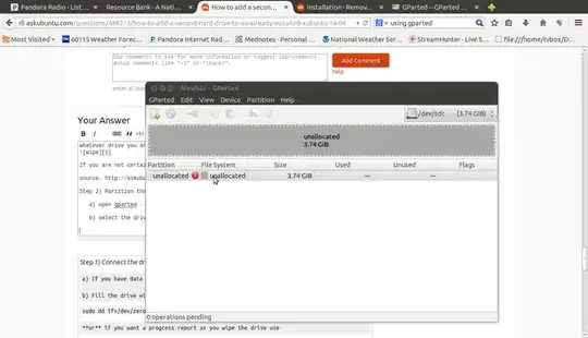

Step 2) Partition the drive. I use gparted.
a) open gparted - your password will be required
b) select the drive you are working with in the box on the upper right
You will see similar to this:
gparted1

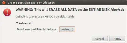

c) create a new partition table. I won't be discussing partition table types here as that's beyond the scope of this answer.
From the menu choose device and then create partition table.
gparted2
Click apply - Gparted will apply the change and rescan the disks

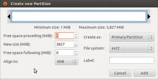

d) format with a filesystem of your choice. I will use ext2 in this example. choose the filesystem that you prefer. ext4 is my preferred filesystem.
Right click on the unallocated line and select new, adjust settings if necessary here then click add.
gparted3

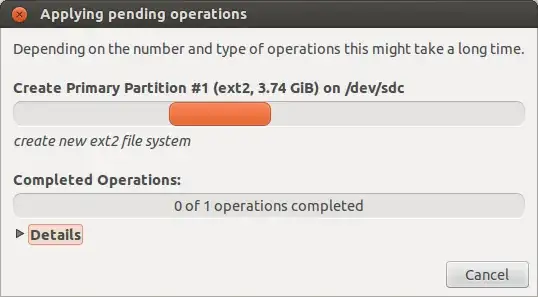

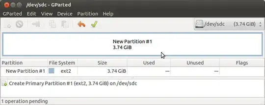

Step 3) Format the drive (put a file system on it) I used ext2 (the default)
gp4
Click the green check mark to apply the format. You will be warned. Click apply
gp-process

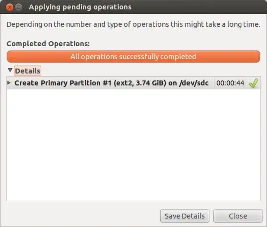

When the process is complete you'll get the below. you can expand details as needed then click close.
gp-complete
