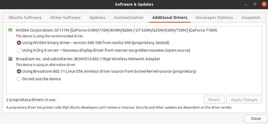

Selecting the proprietary wireless driver solved the problem from me.
Steps:
  1. Search and open "Additional Drivers"
  2. Look for the Wireless Network Adapter driver's entry.
  3. Check if the option "Do not use this device" is selected.
  4. If yes, select the driver of your computer's network adapter which mentions "(proprietary)" in the end.
Here's how it looks on my machine (second driver - Broadcom)
Ravindra S
  • 103
