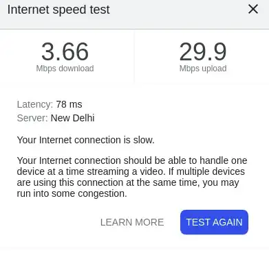

I installed Ubuntu 20.04.2 on my Dell machine Inspiron 3542. Previously on windows OS, the internet through wifi was very good.After I installed ubuntu, I found that download speed is very less, however, the upload speed is relatively good.

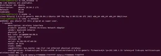

The kernel version installed in my machine is 5.8.0-53-generic.

- Changed the power value from 2 to 3: No significant improvement. Download speed still pretty low < 4 megabits per second

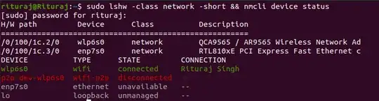

Nothing has worked for me. I think the problem is coming through the kernel. Has anyone faced the same problem. Requesting help.
