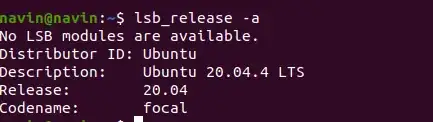

My ubuntu version 20.04.4 when already update
ubuntu version

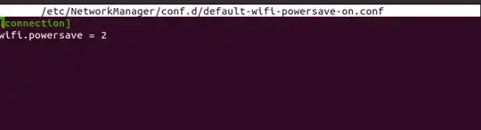

What I have tried:
  • reboot the computer multiple time
  • check if the problem is from hardware, but it is not because of hardware

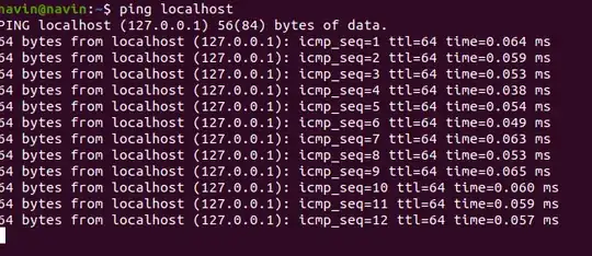

check if hardware problem
try available solution
  • I try to update my ubuntu to version 20.04.4
  • I also try to boot ubuntu 20.04 again on my computer
But all the above solutions no one work for me.

I also changed the wifi.powersave from 3 to 2, but it didn't work.
