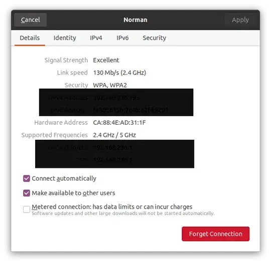

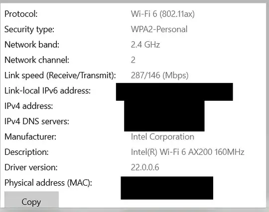

Now, my issue is my throughput on my Windows 10 OS speed test is over 120mbps download speed. On my Ubuntu 20.10, I get a 55mbps download speed. All the other devices connected to my TP-Link AX6000 getting over 200+mpbs download speed. my laptop is the only device that getting less than 200mbps.
Why is that?

  3. Can anyone explain to me why my Windows 10 OS has way faster Link speed/throughput than my Ubuntu 20.10? Is there a fix for this issue?
