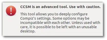

  • Start it from the Dash or by typing ccsm from the terminal.

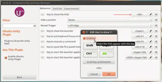

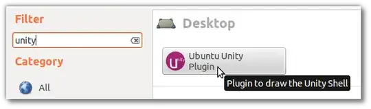

  • Type "Unity" in the filter box on the left, and click on the Ubuntu Unity Plugin:
  • Click on the <Alt> button the red arrow points to, and then uncheck the Enabled box. Click OK and close CCSM -- the Alt shortcut is now disabled.
