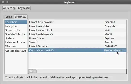

You can easily change the hotkey for the HUD by going to System Settings --> Keyboard --> Short-cuts as in the following picture :
Note that: Clicking ALT fast , shows the HUD. But When you click and hold you can use it easily for another function. I use ALT without any problems.
