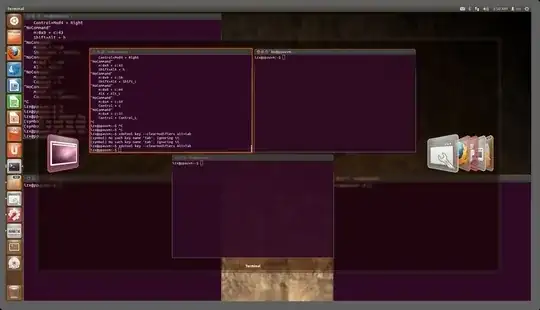

On Ubuntu 12.04, how do I disable or change the Alt+` shortcut which lets you switch between multiple windows of a single application? (see below for Terminal example)
My Windows VM in Korean needs to use that keyboard combination to switch character sets.
