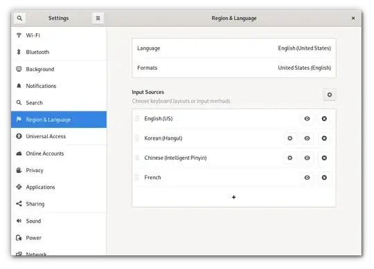

Here's my input settings (notice the order of the languages in the list which is my preference.)

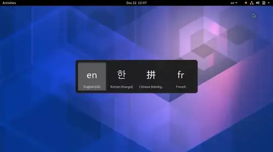

Now initially when I invoke the shortcut to switch the input the list looks like that (as expected) :

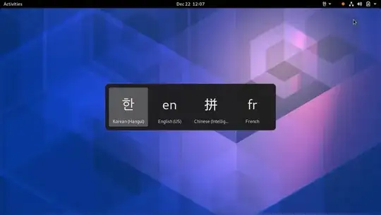

Now I select Korean input (second item) and invoke the switch shortcut again, here's how the list looks like :
As you can see the order changed.
And now if I select another input and try to switch again the list is completely shifted.
Is there a way to prevent gnome from rearranging the list all the time ?
