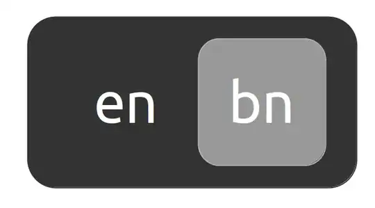

I am using ibus-avro on Ubuntu 20.04. I have 2 input sources: en, bn. I am using F8 to switch the sources. When switching, a large prompt-like thing (I don't know the exact term) is shown on screen. I cannot take a screenshot of it (Print Screen is not working while it is visible), but it looks something like this:
prompt-like thing looks like this
It is annoying, and it also seems to prevent typing for a moment until it goes away. How to hide this and just switch the input source instantly? Thanks.
UPDATE: This issue does not seem that annoying when using Ctrl+Space or Super+Space for switching input sources. In those cases, it only seems to be visible as long as the Ctrl or Super (respectively) key is held down.
