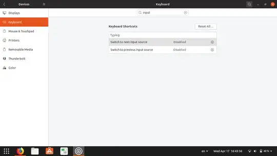

I have disabled the default shortcuts for switch to next input source and previous input source.

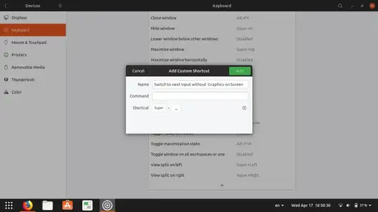

now I can bind any command to Super+Space like below
Thoughts:
It is possible to give these two commands as two shortcuts for example:
Super+Space for English
Shift+Super+Space for Ukranian

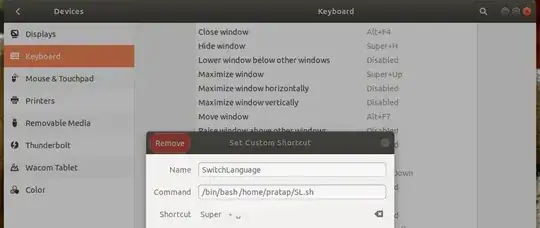

I have saved the below script as ~/SL.sh and created a shortcut with Super+Space as
/bin/bash /home/pratap/SL.sh
#!/bin/bash
CURRENT=`gdbus call --session --dest org.gnome.Shell --object-path /org/gnome/Shell --method org.gnome.Shell.Eval "imports.ui.status.keyboard.getInputSourceManager().currentSource.index"`
if [ "$CURRENT" == "(true, '1')" ]; then
  gdbus call --session --dest org.gnome.Shell --object-path /org/gnome/Shell --method org.gnome.Shell.Eval "imports.ui.status.keyboard.getInputSourceManager().inputSources[0].activate()"
else
  gdbus call --session --dest org.gnome.Shell --object-path /org/gnome/Shell --method org.gnome.Shell.Eval "imports.ui.status.keyboard.getInputSourceManager().inputSources[1].activate()"
fi
now Super+Space is toggling the Languages without graphical representation which I was looking for..
