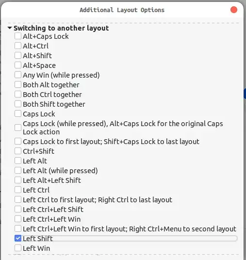

I am switching from windows to ubuntu and would like to achieve the same input method as in windows. I am now using English(US) and ibus-cangjie for input. I want to change the input layout by clicking the left shift. After google, I found that the additional layout setting in tweak can help.
However, the problem is it completely overrides the left shift key. For example, in windows, I can enter capital letters and enter symbols from the number key by long holding shift in English mode. When I do that in Ubuntu, after I long press and hold the left shift key it immediately changes to another layout. Therefore, I cannot input capital letters and symbols with the left shift key.
Is that any way to achieve the correct behavior: when short click the shift button input layout changes and when long press and hold the shift key capitalize letters or enter symbol with number key?

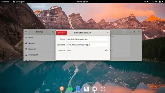

    screenshot
  2. Install the package xcpae with the command sudo apt install xcape
  3. read manpage man xcape
  4. run the command xcape -e 'Shift_L=XF86Phone'
