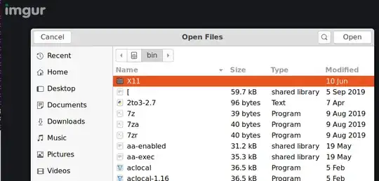

I found a solution by mistake (!). What I wanted to do is have a separate Chromium instance (not just profile). Turns out that removed any sort of access restrictions from Chromium snap (!).
Chromium snap access to /bin/
Here's my ~/.local/share/applications/ChromiumUnsnapped.desktop based on the .desktop file spec:
