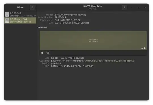

I am brand new to the Linux system, and kind of am learning as I go. Another issue I am running into which I am not sure whether or not may have something to do with some of my current issues, the HDD appears differently in the "Disks" program then the SSD. I formatted the HDD when I first started installing and updating, but it appears to be full even though it allows me to write to the disk, and the disk is brand new.

I included a picture of the "Disks" program if that helps any I have others but I only able to attach one. I assume I am probably doing something wrong. I appreciate any help, because like I said I am learning, and thank you in advance for your effort and consideration.

I noticed that your HDD is not partitioned and that the entire device has an ext4 filesystem. This will work but conventionally you would place one or more partitions on the HDD and then add the filesystem. Without a partition the filesystem is at /dev/sda. Most guide’s expect partitions such as /dev/sda1.

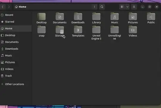

So I have gone back and forth with this, trying to do this in "Terminal" and definitely need to learn more about the "Terminal" commands but I may have solved my own problem on accident. So first I am on 22.04 so it may differ for earlier versions, but
First go to your "Home" directory and copy the directory you want to be your access point for the disk

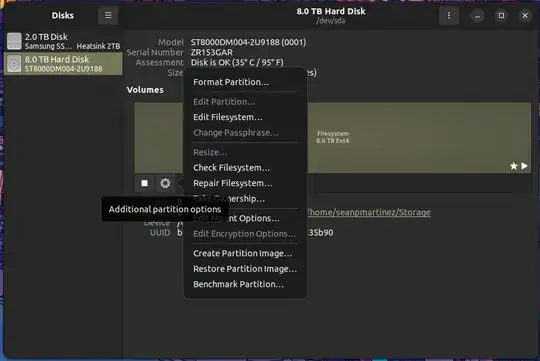

go into "Disks"
select the "Disk" you are trying to make accessible through the "Home" directory
Main click (Left Click for me) on "Additional Partition Options" (the gear Icon next to the start/stop button)

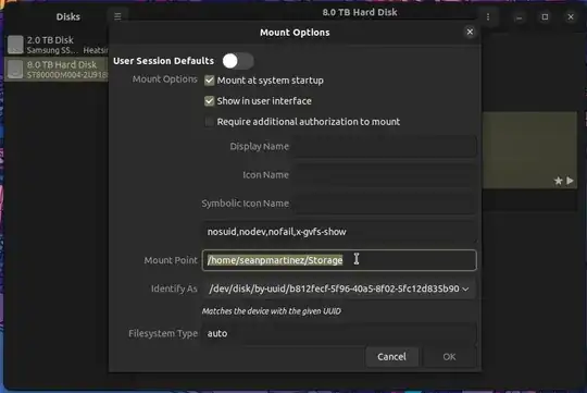

go to "Edit Mount Options"
"Paste" the location of the folder in the "Home" directory you want to make the access point
Verify and restart your PC.
