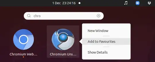

Just run the app as if it is not a snap \o/
So for example chromium
  1. Use a menu editor eg. "Main Menu" to add a custom chromium "menu item" (this is what ubuntu uses to find apps when you press super+a) :
  2. Set Name eg.: Chromium Unsnapped
  3. Set Command: /snap/chromium/current/usr/lib/chromium-browser/chrome --user-data-dir=~/ChrUnsnapped --class="ChrUnsnapped" %U
  4. Set an icon eg. Download a retro chromium logo
  5. save/close
  6. super+a (or Show applications icon at bottom left) find your new item and right-click to add to favorites enter image description here
<rant>
I am so super frustrated with snap that I can't configure my personal /stf dir like I have been doing for 15 years. Thank goodness for this hack, seems I'm going to have to do this for every freeken snap app :'( .
Yeah I know it is bad, but until there is a whitelist configuration, this seems to be the only way for things to go back to normal. I really don't want to put my stuff in /home, /mnt, /media please don't hate your users.
</rant>
