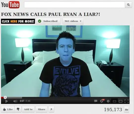

After updating to Ubuntu 12.04 from Ubuntu 11.10, all video is still blue, whether playing in a browser or a player. Same problem occurs in 11.10 as well.
I have tried to uninstall all Flash and re-installed but it makes no difference.
What is causing the blue Flash video?
Ubuntu 11.10 64bit
Ubuntu 12.04LTS 64bit
What it looks like
Blue flash videos

There are some misleading and some wrong recommendations here, so let's sum up what the problem is and what solutions there are.
TL;DR
The latest versions of Ubuntu since 12.10 (Quantal) contain a patched version of the library. If you still run into issues with blue video (NOT including the Blue Man Group), check out this answer – the Flash Player's library name must be libflashplayer.so otherwise libvdpau won't apply the workaround. You may also take a look at /etc/vdpau_wrapper.cfg file. There you can disable the workarounds applied by libvdpau.
If you have Oneiric (11.10) or Precise (12.04), install patched libvdpau:
sudo add-apt-repository ppa:tikhonov/misc
sudo apt-get update
sudo apt-get install libvdpau1
Otherwise you can modify Flash Player's library:
cd /usr/lib/flashplugin-installer || cd /usr/lib/adobe-flashplugin/
sudo perl -pi.bak -e 's/libvdpau/lixvdpau/g' libflashplayer.so
Read the whole post before commenting.
The problem
Flash Player since version 11.2 uses hardware video acceleration on most platforms. Unfortunately the acceleration in Linux is not just unsupported, but essentially broken. Flash Player swaps colors in the video under the following conditions:
  • You are using a fairly new Nvidia GPU with VDPAU support.
  • You are using current version of Nvidia binary driver (older versions don't support VDPAU).
  • You have libvdpau1 package installed.
  • The player on the site uses Stage Video – that's why only YouTube and few other players are affected.
See the explanation by Pierre-Loup Griffais from Nvidia.
This is not a bug in Nvidia drivers. Nvidia is aware of this problem and they have already created a workaround. Nouveau driver isn't probably affected because the video decoding support is not yet finished.
This is not a bug in libvdpau. libvdpau is just a wrapper which allows video players to use VDPAU decoding (see Stephen Warren's explanation).
This is not an Ubuntu-specific bug. Other distributions are affected as well, e.g. Arch.
The bug is very possibly in Flash Player – although Adobe tries to blame Nvidia and incompetent users. There have been multiple reports on Adobe's bug tracker, all of them were rejected as “CannotReproduce”:
There won't be an official fix from Adobe, since NPAPI-based Flash Player receives only security patches until 2017. Hopefully we won't need Flash Player by that time.
