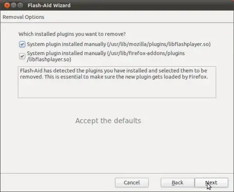

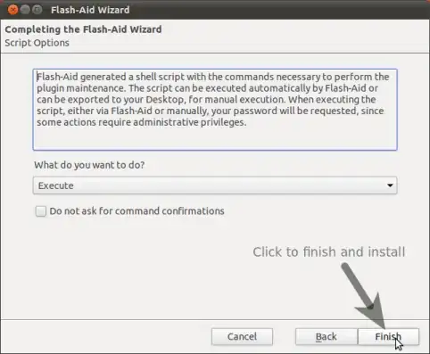

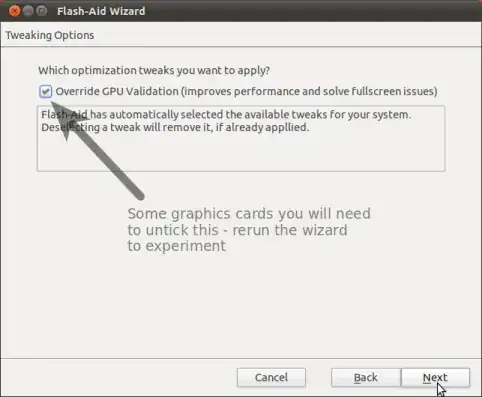

26
As you have identified - the best solution is usually to follow this Q&A to install flash. It does work for the vast majority of users.
Flash-Aid was discontinued by it's author and is unknown if it will be back, the following are kept only for historical reasons.
As an alternative, one of the best tools I have found that allows you to configure Flash correctly during installation is the Flash-Aid addon - use the author's site or search on the Firefox addon-manager for Flash-Aid
This will remove any remnants of of Flash installation and install flash directly from the Adobe Website. During the wizard installation you have a few configuration options that you can try to resolve flash-player issues.
Close & Restart Firefox / reboot for the change to take effect.
See also:

Install the Flash Aid Firefox plugin
I don't know for sure if this will work for you as well, but it worked for me.
Install Flash Aid, restart Firefox, and click the Flash button at the upper right corner of Firefox's window. Just follow the instructions in the wizard and you should be fine.
For some more detailed guide on installing Flash using Flash Aid, check out fossfreedom's answer: https://askubuntu.com/a/86260/18953

I am running Ubuntu 12.04 64-bit with an Nvidia GeForce 8400 GS.
I have been having the same issue ever since I corrected another Flash issue on my system related to Nvidia GPUs -- see Flash video appears blue on this forum. Following the workaround posted at the previous link stopped the unwanted behavior of all Flash video being tinted blue, but ended up causing the Flash plugin to crash nearly every time I attempted to watch a video online.
The solution for me was to look back at /etc/adobe/mms.cfg and remove everything but one line, which should read:
OverrideGPUValidation=true
This idea and others are discussed on ubuntuforums, and many other places. Please try changing your mms.cfg (or creating it, if it does not already exist) and post back with your results. Good luck!

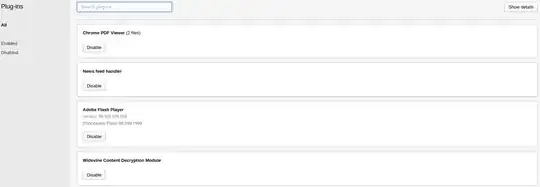

I managed to Enable the Adobe Flash plugin in Opera by following the instructions from this Russian post.
Let us begin installing Flash:
  • Install PepperFlash via apt: sudo apt-get install pepperflashplugin-nonfree
  • download & extract the Adobe Flash: https://www.adobe.com/support/flashplayer/debug_downloads.html
    • get the "Download the Flash Player Plugin content debugger (64-bit) - NPAPI" version (note that if your running on 32-bit architecture, you need to select the 32-bit one)
  • Extract: tar xvf <archive_name>
  • Move the file libpepflashplayer.so to /usr/lib/pepperflashplugin-nonfree/
  • Restart Opera. and you're done.
I can now see them installed:
  • and on about://plugins
