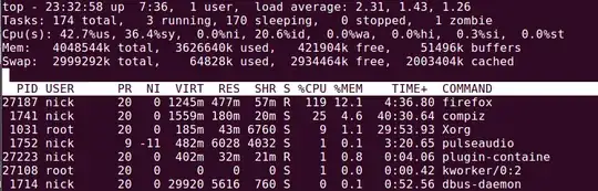

When I play video on YouTube CPU usage rises to 100% in both Firefox and Chrome.
What I'm running:
  • Processor Intel Core2Duo E4500 2 x 2.2GHz
  • Ubuntu 12.04 amd64 with latest updates
  • Flash Plugin adobe-flashplugin 11.2.202.233-0precise1
  • Firefox 12.0+build1-0ubuntu0.12.04.1
  • Google Chrome 18.0.1025.162
top output
Is this normal? And what can I do with this?
