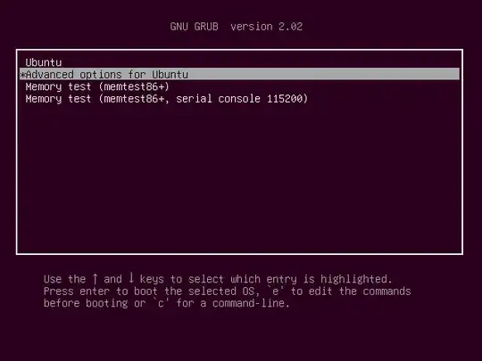

  2. Hold the Shift key as soon as you pass the BIOS logo to enter the GRUB boot menu. You might need to repeat steps 1 and 2 a few times before you finally succeed.
  3. Once you see the options screen, select Advanced options for Ubuntu and press Enter:

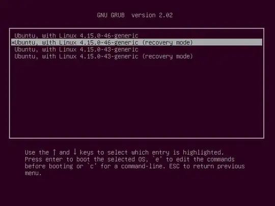

  4. In the next screen select the second line (the on with recovery mode) and press Enter:

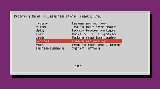

  5. Wait for the initial boot process to finish and a second screen with options appears. Select Enable networking and press Enter:
  6. If presented with a yes/no screen, choose yes and press Enter:

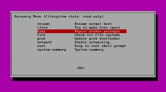

  7. If all goes well, you should be now connected to the Internet. You will know if it succeeds when the options screen shows up again. Now select Repair broken packages and press Enter:

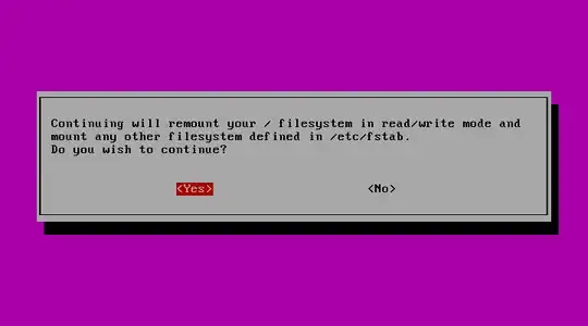

  8. If presented with a yes/no screen, choose yes and press Enter:
