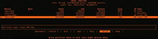

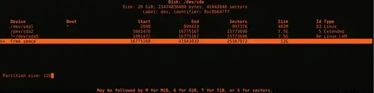

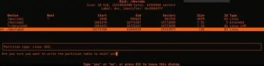

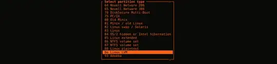

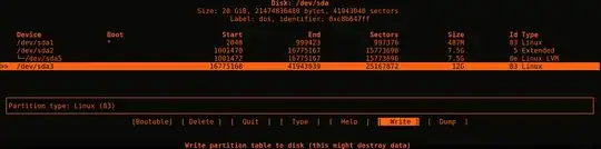

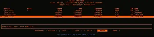

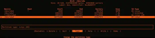

  1. ssh into the system, switch to root and run cfdisk
    # cfdisk
  2. enter image description here
  3. enter image description here
  4. enter image description here
  5. enter image description here
  6. enter image description here
  7. enter image description here
  8. enter image description here
  9. enter image description here
  10. enter image description here
  11. enter image description here
  12. enter image description here
  13. After exiting cfdisk
     # fdisk -l /dev/sda

     /dev/sda3       16775168 41943039 25167872   12G 8e Linux LVM (***** See new partition /dev/sda3*****)
     /dev/sda5        1001472 16775167 15773696  7.5G 8e Linux LVM

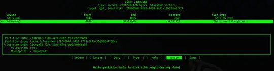

2. Faster Method Tested in Ubuntu Server 18.04.3 LTS
This method is a little faster than the first. This is due to a new option in the cfdisk menu called "Resize" that saves some steps.
After extending the volume in VMware ESXi (shutdown vm, backup/export vm, remove all snapshots, then increased number in disk size, take snapshot of vm again before following the next steps so you can revert mistake/error).
The following example is extending volume on root partition on a system that is already using LVM.

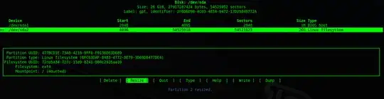

  1. ssh into the system, switch to root and run cfdisk.

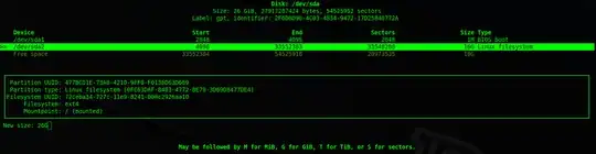

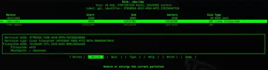

  2. Choose the partition to extend and select "Resize". enter image description here
  3. Set the "New size". enter image description here
  4. After pressing enter, you'll see screen with the following note "Partition [someNumber] resized": enter image description here

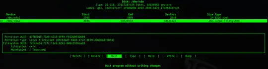

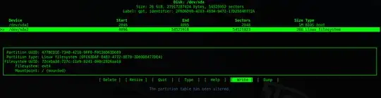

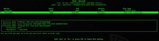

  5. Next you'll need to "Write" (save) your changes: enter image description here enter image description here enter image description here
  6. Quit cfdisk. When you exit you may see message "syncing disks". enter image description here enter image description here
  7. I rebooted my system at this point but it may not be necessary. Now you can pickup from step 19 from the first method (repeated below).

The answer from Sergey was excellent. If you have the empty space not directly in the next device, however, you will need to delete other devices. For example:
Device     Boot    Start       End  Sectors Size Id Type
/dev/sda1  *        2048  33556477 33554430  16G 83 Linux
/dev/sda2       33556478  41940991  8384514   4G  5 Extended
/dev/sda3       41940992 125829119 83888128  40G 83 Linux
/dev/sda5       33556480  41940991  8384512   4G 82 Linux swap / Solaris
In the above case, if you want to merge /dev/sda3 with /dev/sda1, you would need to remove /dev/sda1, /dev/sda2, and /dev/sda3 (with d command), and re-add /dev/sda2 and update its type (with n and t commands).

I succeeded in enlarging my primary ext4 partition using the methodology described here.
Some notes from my personal experience:
  • The link example is for shrinking partition, hence the order is resize2fs first and then fdisk. When enlarging partition (as in my case) the order should be fdisk first, reboot and then resize2fs. Also, when using fdisk, the primary as well as the extended partitions should be removed and re-defined.
  • I booted the Ubuntu from another drive and then worked on this drive which actually was mirror (using dd) of the older drive. Made it bootable using GParted
  • The current version of resize2fs (I am using Ubuntu 12.04LTS) support ext4 - no need to do the actions described in the link of changing it the ext2.
