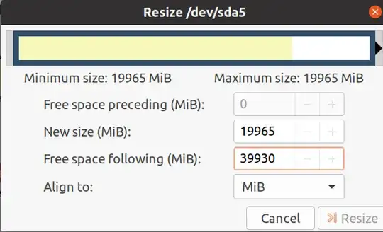

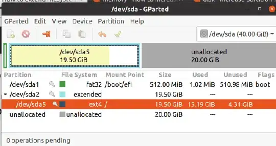

I can't follow the procedure because I have no line item that corresponds to a swap partition (at least not that I recognize). I assume that sda5 is my main file system since it is 20GB and mostly used. I right-clicked it and chose "Resize/Move".
The new size "19965" seems suspiciously close to the original 20GB size, so I entered 2x that amount (39930). Unfortunately, it is not accepted. If I press Return or Tab, it reverts back to 19965. I can't simply click the "Resize" button because it is grayed out.

(3) Use fdisk /dev/sda
After launching the fdisk app using fdisk /dev/sda, I entered p to see the partitions:
Device    Boot   Start      End  Sectors  Size Id Type
/dev/sda1 *       2048  1050623  1048576  512M  b W95 FAT32
/dev/sda2      1052670 41940991 40888322 19.5G  5 Extended
/dev/sda5      1052672 41940991 40888320 19.5G 83 Linux
Again, I have no swap partition. Since the procedure refers to a swap partition, I abandoned this as well.
