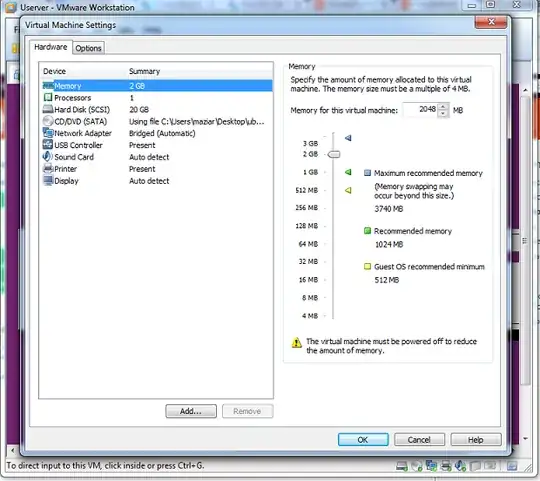

I have installed an Ubuntu server on a VMWare workstation with a space of 20GB storage as seen below:

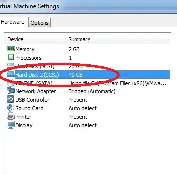

After the installation I've attached another 40GB worth storage to the existing Ubuntu server installation (seen below):
Now I want to add this 40GB to my / (root) directory it mean's I want that my / directory became to 60G , like it will be resize from 20G to 60G (20G + 40G), i don't know what should i do, can any body help me ?
