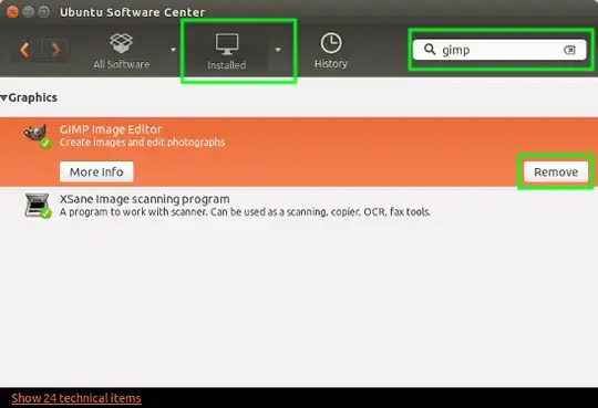

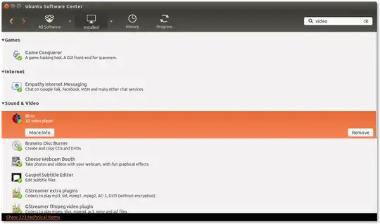

  • The software centre: find the package, click remove
In the "installed" tab, search for the program; a "remove" button shows at the bottom right of the program description

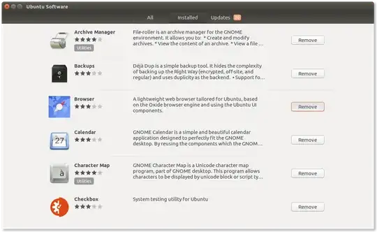

GUI Methods
Ubuntu Software
The easiest way is to use Ubuntu Software (or Ubuntu Software Center in releases older than Ubuntu 16.04LTS). Open Ubuntu Software, click the Installed tab, select the app you wish to uninstall, and hit the Remove button.
Uninstall Apps using Software
Uninstall Apps using Software Center

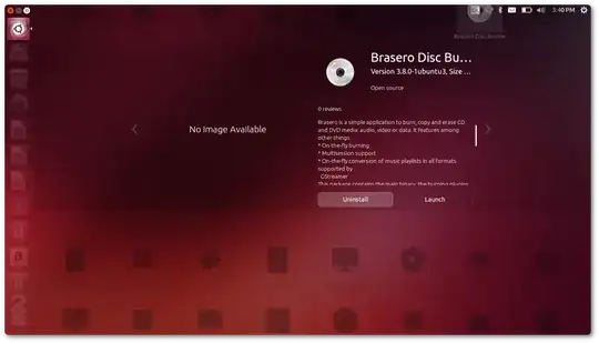

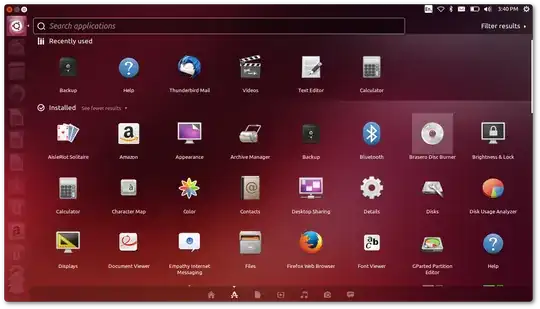

Unity Dash (from Ubuntu 12.10, till 17.10)
Ubuntu 12.10 brought Unity 6, which introduced the Preview feature. So, from Ubuntu 12.10 onwards, you can just right click on (almost) any app icon on Unity Dash and click uninstall. Note that this won't work on Ubuntu 18.04 LTS and above, as Unity was dropped and GNOME was made the new desktop.
Unity Dash Uninstall Apps from Unity Dash
