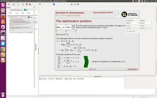

UPDATED: I did lookup for all LibreOffice packages in Synaptic and "purged" them before reinstalling, but I still have problems as you can see from the following screenshot (editing math formula is not the only problem, but it is the most repeatable one, so I am using it as a benchmark of things working or not) Screenshot of editing formula
