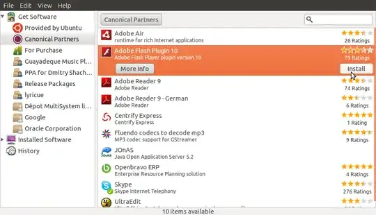

For 11.04 and earlier:
Are you installing it from the Ubuntu Software Center?
  1. Go to Applications->Ubuntu Software Center.
  2. Click on Canonical Partners
  3. Click the Adobe Flash Plugin 11 and click install.
Note: this is the method I use on my 64-bit Ubuntu install and it has yet to fail me.

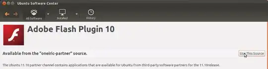

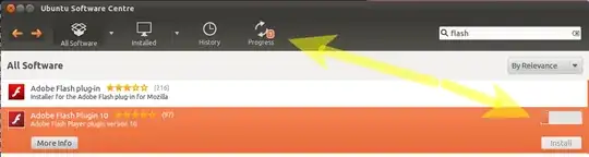

For 11.10 and later

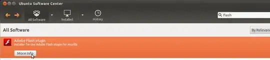

Start Software Center from the Launcher and search for flash
Two entries will be found. The first is the wrapper around the 32bit flash version from Adobe. The second is the 64bit flash version.
Select the second flash entry - if the following picture is seen then you have not already enabled the Canonical Partner Repository previously.
Click More Info
... and click Use this source to enable the Canonical Partner Repository
see the end of this answer for the bug-report

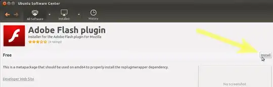

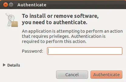

Click Install
Click the Install button and enter your password when prompted. Note - you must have permission to install software.
The installation will proceed:

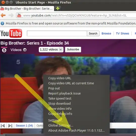

Once complete - launch Firefox and browse to your Flash Video. Right click and confirm that the latest version of Flash has been installed correctly.

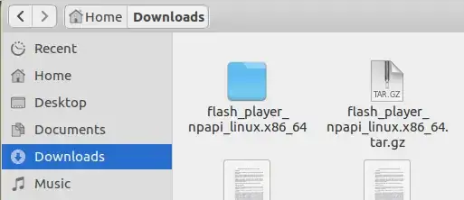

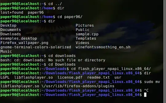

This is how to install Adobe Flash Plugin for Firefox:
  1. Go to this page and select the option .tar.gz for other Linux. Download the file.
  2. Unpack the plugin tar.gz and copy the files to the appropriate location.
  3. Save the plugin tar.gz locally and note the location the file was saved to.
  4. Launch terminal and change directories to the location the file was saved to.
  5. Unpack the tar.gz file. Once unpacked you will see the following:
    • libflashplayer.so
    • /usr
  6. Identify the location of the browser plugins directory, based on your Linux distribution and Firefox version.(Usually it is /usr/lib/mozilla/plugins/)
    For ubuntu 14.04 path is : /usr/lib/firefox/browser/plugins
  7. Copy libflashplayer.so to the appropriate browser plugins directory. At the prompt type:
    sudo cp libflashplayer.so <BrowserPluginsLocation>
  8. Copy the Flash Player Local Settings configurations files to the /usr directory. At the prompt type:
    sudo cp -r usr/* /usr
  9. Now restart your browser.

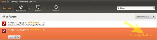

Well I post this here, in hopes of helping someone. I'll state what was happening and how I solved it.
SETUP:
Running 12.04 from a WUBI installation.
PROBLEM:
When I searched in the Ubuntu Software Center the keyword flash, none of the options posted here appeared except ONE for a flash plugin for Mozilla. When attempting to install it, I got a dependency error.
Tried installing it through the Ubuntu Restricted Extras from Ubuntu Software Center, however the flash plugin portion of this installation did not work because of the dependency error.
Kept searching and found this command to install the plugin
sudo apt-get install flashplugin-nonfree
and ran it from the terminal.
Same dependency error with this output:
Reading package lists... Done Building dependency tree
Reading state information... Done Note, selecting 'flashplugin-installer' instead of 'flashplugin-nonfree'
Some packages could not be installed. This may mean that you have requested an impossible situation or if you are using the unstable distribution that some required packages have not yet been created or been moved out of Incoming.
The following information may help to resolve the situation:
The following packages have unmet dependencies:
 flashplugin-installer :
 Depends: libnspr4-0d but it is not going to be installed E: Unable to correct problems, you have held broken packages.
SOLUTION:
I ran
sudo apt-get install -f
and then
sudo apt-get update
which I found from some other post that was trying to solve dependencies.
Then I ran
and flash plugin now works on Chromium and Firefox.

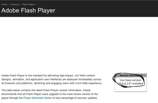

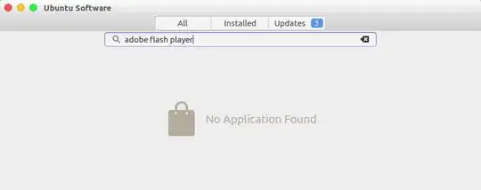

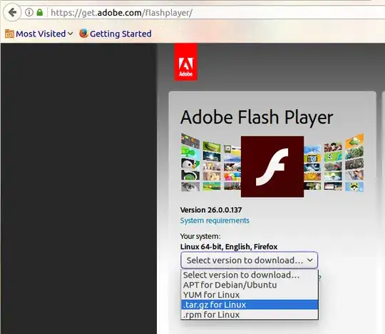

Linux is not supporting Adobe Flash Player in its store anymore.Therefore you have to do it manually.
adobe flash player
This is only verified on Firefox also if you have Chrome/Chromium you don't have to install it.
There is a procedure of Manual Installation of Adobe Flash Player on Ubuntu, follow these steps :-
  1. Open this link. It will automatically suggest you a version according to your desktop environment.
  2. Select .tar.gz for Linux option as shown in below screen-shot.
  3. Now click on Download Button (Select the downloading path as Downloads in your system for easy access).
  4. Now extract file by Right clicking on folder and selecting Extract Here option.
    file in downloads folder
  5. Open Terminal CTRL+ALT+T and copy below command one by one
    5.1. cd ../
    5.2. cd your-pc-name (eg; paper96)
    5.3. cd Downloads (this is the folder where you have downloaded the file in Option 3).
    5.4. cd flash_player_npapi_linux.x86_64 (Your file name may be different just copy name of file and paste it in terminal)
    5.5. sudo mv libflashplayer.so \/usr/lib/firefox-addons/plugins hit enter and thats it.
    terminal commands
  6. Now close your browser(Firefox) and Terminal.
  7. Restart Firefox and now you have Flash Player in your browser. Visit this link to verify.
    new version of flash player

I checked many answers on this topic in the past week. Finally I found a link with a solution that DOES work:
https://ubuntu-mate.community/t/tutorial-flash-player-for-chromium-and-firefox/3598
Basically, the answer is that it seems to be removed from all software sources and you need to download an old version and install it manually
palbeda
