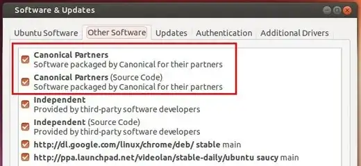

First open Software & Updates from the Unity dash, then enable the partners repository under the Other Software tab.
After that, press Ctrl+Alt+T on the keyboard to open the terminal. When it opens, run the commands below to install flash:
