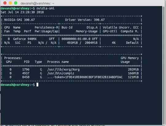

This is my terminal output of Nvidia Drivers.
My Nvidia Drivers
devansh@varshney:~$ nvidia-smi
Wed Apr 24 01:14:16 2019
| NVIDIA-SMI 418.56       Driver Version: 418.56       CUDA Version: 10.1     |
| GPU  Name        Persistence-M| Bus-Id        Disp.A | Volatile Uncorr. ECC |
| Fan  Temp  Perf  Pwr:Usage/Cap|         Memory-Usage | GPU-Util  Compute M. |
|   0  GeForce 940MX       Off  | 00000000:01:00.0 Off |                  N/A |
| N/A   52C    P5    N/A /  N/A |    254MiB /  2004MiB |      0%      Default |
| Processes:                                                       GPU Memory |
|  GPU       PID   Type   Process name                             Usage      |
|    0      3975      G   /usr/lib/xorg/Xorg                           108MiB |
|    0      4002      G   /usr/lib/firefox/firefox                       1MiB |
|    0      4350      G   /usr/bin/gnome-shell                         137MiB |
|    0      5204      G   /usr/lib/firefox/firefox                       1MiB |
|    0     24924      G   /usr/lib/firefox/firefox                       1MiB |
