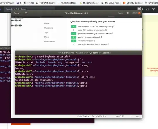

My Ubuntu OS' version is 18.04.1 LTS.
When I start gedit, this is the result gedit screenshot:

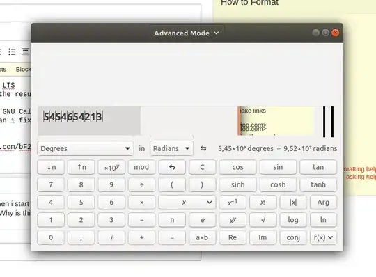

Same problem arises with GNOME Calculator:
I think some things wrong with GNOME programs. I wish to know followings:
  • Why is this happening?
  • How can i fix this?
You could experience a problem related to input method modules. (https://bugs.launchpad.net/ubuntu/+source/gtk+3.0/+bug/1760818)
Try starting e.g. gedit by disabling GTK_IM_MODULE
GTK_IM_MODULE=none gedit
and check whether the issue is gone.
If it is gone, you could try to set GTK_IM_MODULE to none by invoking
im-config
and selecting choice "none" in the dialogs.
A reboot is necessary, afterwards.
