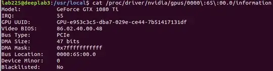

cat /proc/driver/nvidia/gpus/{tab}/information
You should see correct model of your GPU: enter image description here
