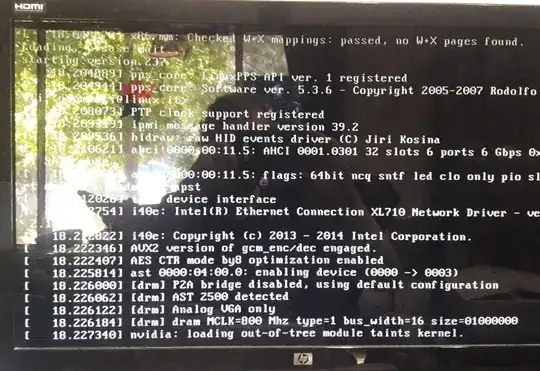

My boot process locks up at the time it hits the nvidia module:
It was booting just fine earlier, only there was an upgrade today which I ran from X-Windows and later when I rebooted that's what I've got. I though I rebooted once in between though. I tested with various resolutions and two monitors, but before the reboot I'm on the same monitor I started with and same resolution. I really don't see why it would block unless the upgrade did break something.
What would you do from that point? Attempt a repair?
Note that the DRM says "VGA only" although the output is HDMI.

In this case it gets stuck somewhere else, possibly because nVidia is not part of that kernel? Last it says:
i40e fw 3.1.55727 api 1.5 nvm 3.31 0x80000c92 1.1747.0
Before that it handled the USBs and ahci.

Ah! About point 3, I paid attention on my last reboot and the screenshot I have up there is where it stops. That's more or less the point where nVidia takes over and switches to graphics mode. However, as we can see the video card output remains frozen to whatever was there at the time of the unfinished switch. So there was probably more output, it was just not visible. Were I able to see that, maybe I'd see the attempt to mount the LVM which takes minutes before continuing.
I know that with older versions, the nVidia driver tends to time out quickly. If your system takes too long to boot, then you are in a weird mode where the graphical target is only half way initialized and there is nothing you can do (in my case, somehow, the keyboard would die; but otherwise you may be able to use Ctrl-Alt-F12 to get out of that mode and back to the text console. From there you can then look for what's taking so long that X doesn't get started in time for the nVidia driver to be happy).
So I think I'll change my default target to console and start X-Windows manually. Over time, it will probably help me not waste hours trying to debug something which isn't a problem in itself (i.e. since it probably would have booted as expected had I waited long enough; although I thought I did wait at least as long as it took to boot in recovery mode...)
