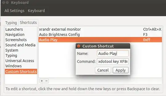

Then in Ubuntu 16.04 go into Settings >> Keyboard >> Shortcuts >> Custom Shortcuts:
  • Set the name to Audio Play
  • Set the command to xdotool key XF86AudioPlay
  • Then click the Apply button
After adding the new option the assigned shortcut key will read Disabled. Click on Disabled and when prompted for key to assign press the Caps LocK key.

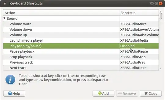

Make sure the keyboard shortcut is set properly
  1. Open Keyboard Shortcuts (System → Preferences → Hardware → Keyboard Shortcuts)
  2. Ensure that "Play (or Play/Pause)" is set to "XF86AudioPlay"
  3. If it is not, click on the "Shortcut" section and press your new Play/Pause key to set the shortcut. helpful screenshot
