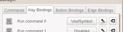

  4. Enable Commands plugin then add the following
    • Add xdotool key alt+F2 to the first available command slot
    • Goto 'Key Bindings' tab. In the same slot number assign Caps Lock key.
      Note: It will show VoidSymbol as the button assigned but this is fine.
