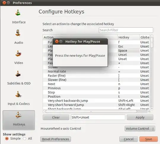

13
VLC comes with configurable hotkey definitions. To access the hotkey menu open Tools -> Preferences -> Hotkeys:
The key for a given action can be determined by clicking on the line in between Clear and Apply. Then a window pops up to ask you for the new key combination. Press Apply to save these.
This procedure works fine with standard keyboard keys. However depending on keyboard hardware layout multimedia keys may not be recognized correctly (bug #419795, Videolan Support, Videolan on Ubuntu 10.10)

10
I use Ubuntu 14.04(64-bit) and VLC 2.1.5
In VLC, go to Tools > Preferences > Hotkeys. You will find three columns Action, HotKey, Global.
See the image uploaded by the user Takkat.
Click on the Global column[Next to the HotKey column] corresponding to the Action you seek, enter the media key combination and click Save.
Restart VLC.
