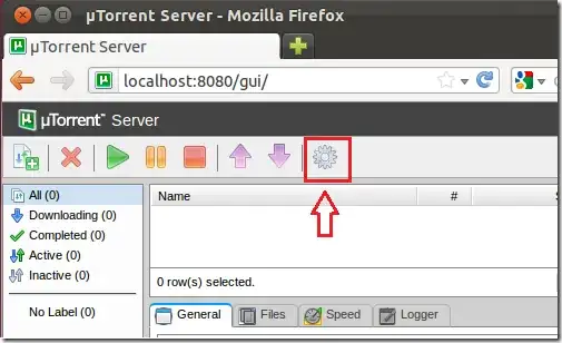

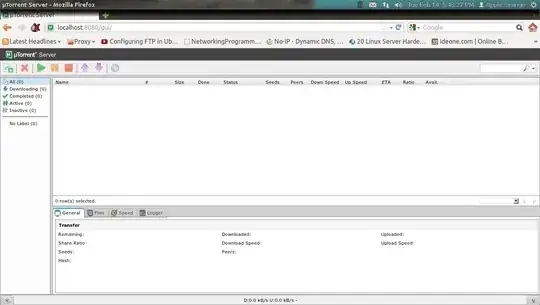

Now that uTorrent server is started, open your web browser (Firefox) and type the address below.
http://localhost:8080/gui/
The username is admin and leave the password field empty. enter image description here

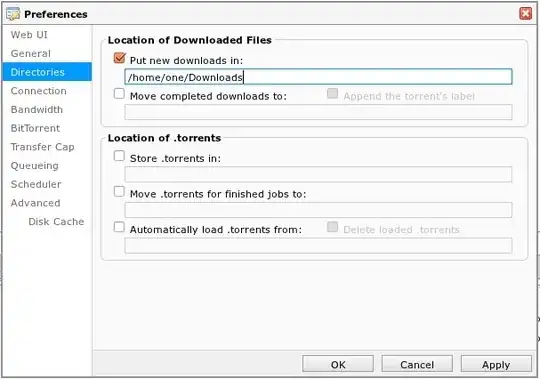

The first thing you will want to do is specify the download folder. To do that, click ‘Settings’ button.
enter image description here Then scroll down to ‘Directories’ and specify the download folder. enter image description here

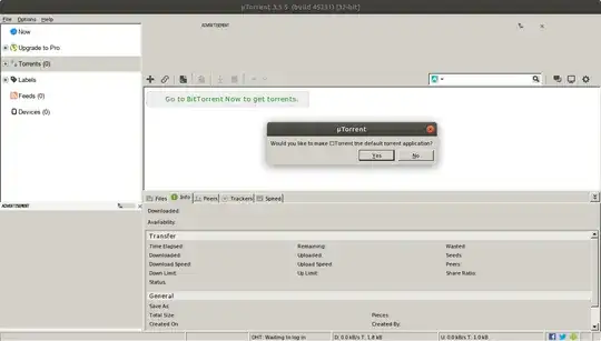

µTorrent is packaged as a snap package which uses Wine in all currently supported versions of Ubuntu. It still has an old-fashioned Windows application graphical user interface as shown in the below screenshots. µTorrent can be installed with the following command:
sudo snap install utorrent
Run this command to launch utorrent from the terminal:
snap run utorrent
µTorrent can also be launched from the Dash by searching for µTorrent with the first letter µ. It's not very convenient to copy/paste µTorrent every time you want to launch it from the Dash, but you can add the µTorrent icon to the Dock or if you use µTorrent frequently its icon will appear in the Dash by pressing the Frequent button. The best way to solve this problem is to add µTorrent to the Dock and then after it starts to show up in frequent apps in the Dash you can remove from the Dock and start it from the Dash instead.

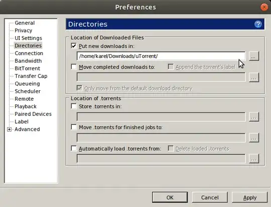

To change the directory of your µTorrent downloads select Options -> Preferences -> click on Directories from the list in the left pane -> click the button to the right of the Put new downloads in text entry box -> browse to the new µTorrent downloads directory.
µTorrent download directory
