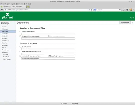

  2. Add this as autoload directory:

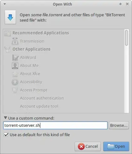

  4. Associate *.torrent files to this script
Voila! It should work.
