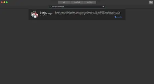

search in Ubuntu software update app "synaptic package" and install it

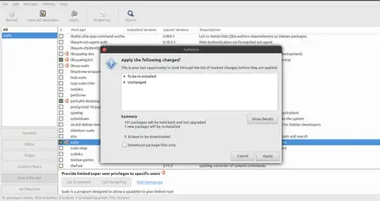

image:

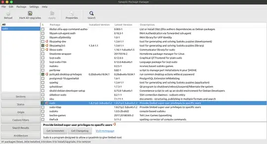

2- open app
3- on top of page click on search box and text "sudo" now find the "sudo" in list > and click on solid square & on the opened square select on "mark for reinstallation" > then click on Apply on top of page and install it
