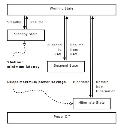

Jargon
Suspend to RAM - RAM keeps the data, computer goes to sleep faster, uses more energy when suspended, wakes up faster. Some call this sleep.
Suspend to disk - aka hibernation. RAM is saved to swap (partition or file), computer goes to sleep slower, uses less energy while hibernating, wakes up slower.
Suspend-to-RAM in Linux by Rafael J. Wysocki and A. Leonard Brown
