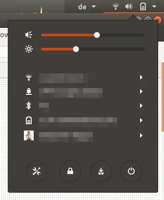

I found a new extension which adds a new button for hibernation. It works fine with touch screens and convertibles because it is a separate button. There is on drawback though: it does not (currently) work from the lockscreen.
It was easy to find in Ubuntu 17.10, I just had to search for hibernate and select the corresponding result of the section for software results. Hibernate and Gnome extensions were already set up, if you have problems with these I suggest you look for the corresponding Q&A here at this site.
Also you can still configure the power button to hibernate your computer instead of shutting it down (settings > power options), if that is what you want.
