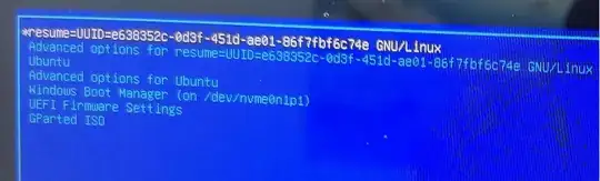

EDIT: I removed the swapfile and created a swap partition to try to resume from there, following the instrucions in https://help.ubuntu.com/community/SwapFaq and https://www.geeksforgeeks.org/how-to-enable-hibernate-in-ubuntu-22-04-lts/. (As a consequence, I now see the following GRUB menue enter image description here
EDIT3: this was only happening because I messed up the boot menu, I fixed it and now it behaves exactly like with the swapfile) But it still doesn't resume any of the apps I have open before hibernating. Could there be anything that keeps my laptop from writing the RAM to the swap partition?

In my boot script made with GRUB Customizer I had the line
linux   /boot/vmlinuz-6.2.0-39-generic root=UUID=5147e4a0-81c2-440a-ba09-ae762f4304fb ro  quiet splash $vt_handoff
Where the "quiet splash" looks like the GRUB_CMDLINE_LINUX option I had to change in the /etc/grub/default, so I guessed that this script is setting up all the boot options and ignoring /etc/default/grub.
Therefor I added the resume=UUID=X to this line
linux   /boot/vmlinuz-6.2.0-39-generic root=UUID=5147e4a0-81c2-440a-ba09-ae762f4304fb ro  quiet splash resume=UUID=e638352c-0d3f-451d-ae01-86f7fbf6c74e $vt_handoff
and now it works!
